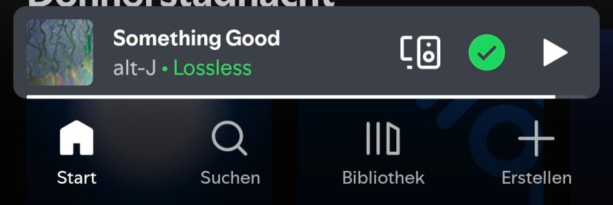

How did you disable Google cast? In my app it is not enabled, but Spotify shows only my Pro via Google Cast. So no connection to Spotify possible.
You need to enable Google Cast in order to access the screen with the toggle to disable it.
I also never enabled Google Cast but my WiiM Pro still advertised _googlecast._tcp. via mDNS/DNS-SD before I turned it off with that option. It's possible enabling Google Cast (which involves agreeing to Google terms of service/privacy policy) is required to actually use Google Cast (I never tried) but the service is running by default. The toggle shown in the screenshot in the linked post stops the service running.
