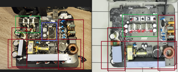

The few issues with coil whining were limited to the very first PCB versions 2 and (to a lesser degree) 4. And even then not every unit would develop this behaviour. Any WiiM Amp you pick up from a dealer right now will have a PCB version >= 5, which are known to be trouble free.

Fml I got pcb v5 as attached! Clicky knob, metal binding posts and no underside vents :confused:
I hear the latest pcb v7 has 4 layers Wiim Amp Pro PCB! I took a comparison between WAU and WA as attached. Interestingly Wiim seems to use the same PSU design for both marked red. They shifted the TPA section marked green into the center with WAU and the Amlogic SOC marked blue i guess is flipped underneath for WAU and that part is cooled with the heatpipe
I think WA PCB v7 has the heatpipe hence the bigger vents.
My PCB v5 seems to run hotter by ~5C against my WAU. I wonder can i exchange it, im OCD about it!
With nerdy bit outta way. I was not prepared for WA to take up some footprint. It is quiet bigger than my expectations :D
What i was not expecting too, was how super easy to get it running and tuning with my WAU experience. Seriosuly the Wiim Home app is powerful and i am someone who disliked using apps!
I am now connected to my old Q1010i i found in my store and it blew away the bundled LG sound bar + sub. Hdmi ARC works just as i wanted! I see the value in buying Wiim than say trying my luck with the failed Onoorus D3 in such matters.
