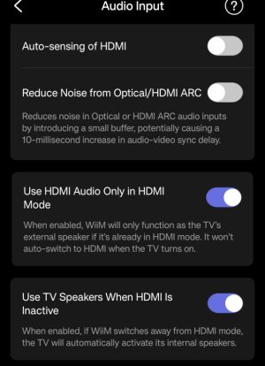

It's a little difficult to understand why your TV in standby will interrupt the WiiM. The TV must not show it's present on HDMI ARC CEC, unless it has active audio output.
I have the following settings, as I prefer to have full manual control of ARC.
What is your settings?
I would expect auto-sensing to be on and the rest to be off.

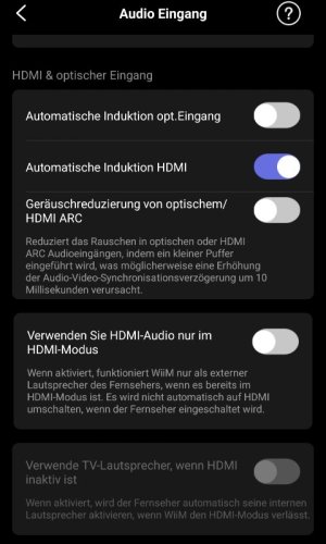

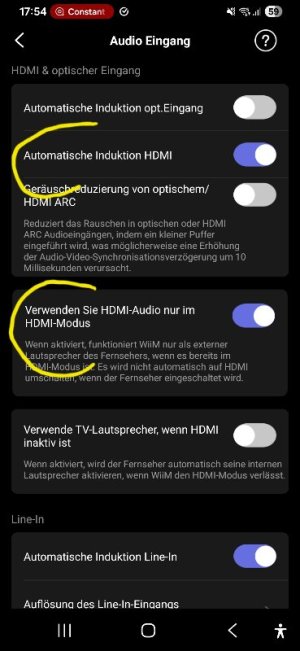

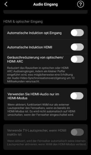

I like the automatic switch to hdmi if I use the TV during watching.
Both switch positions are tried, both have the same effect, automatically switching AND unfortunately interrupting my music steam.... don't understand it.
This is the effect since the firmware mentioned above.
