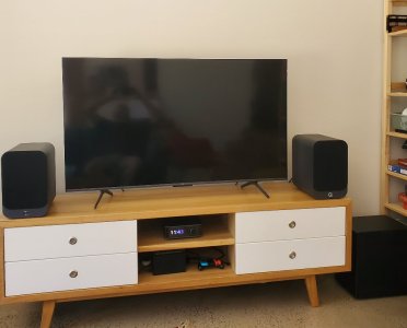

I have a Wiim Amp Ultra , Q acoustics 3030i and a good 10" sub.
Great for listening to music.
However when plugged into the TV the dialogues are muffled, can't be heard as clearly as when using the TV speaker (which isn't great).
I've tried changing the EQ in the Wiim App to "voice" which improves things a little bit but still not nearly good enough.

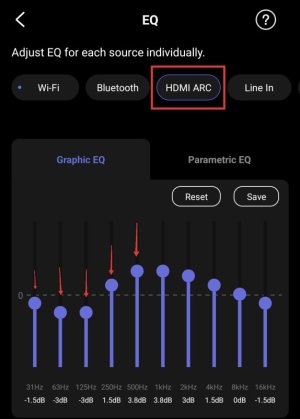

Hi
All I can say right now is that you can't use plan 3.
Have you tried customizing the Vocal Booster EQ?
Change the EQ for the HDMI input to Vocal Booster, then (e.g.) gradually lower the bands below 500Hz until the vocals become clearer. If this doesn't work, consider other methods.
Thanks Wiimer.
Thanks for the suggestion. I only tried the voice pre-set in the Wiim home app. I will try adjusting the EQ as you suggested.
