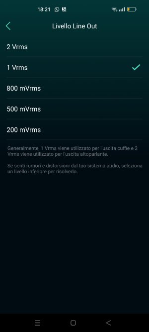

good evening, my Marantz 54 SE amplifier, if I'm not mistaken, has an AUX input sensitive at 150 mV but in the App it is currently possible to set the output to 1 or 2 Vrms without intermediate possibilities. I ask the developers if it is possible to make a firmware change to also allow 1.5 Vrms output. thanks in advance and good work!
I hope I'm not making a mistake and ask if my reasoning is correct. otherwise, with the current possible settings and the 150 mV sensitivity of the aux input of my amplifier, what setting would you set on the output from the Wiim?
Most components have 2V output. Try both. I think the only difference will be that you will need to crank the volume more at 1V.
My Amps are also 0.15v sensitivity. I find that the WiiM is way to loud too early in the dial at 2v. At 0.5v it sounds right at the 12 o’clock on the volume dial.

I used to use 10dB attenuators between my DAC and amplifier to get more movement of the volume control so similar to you.
