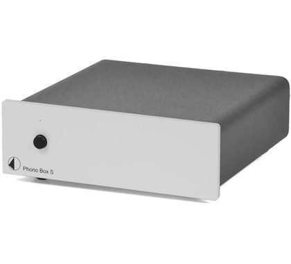

What gain have you set on the pro-ject?
According to this the gain is switchable.Gain? There’s no gain setting on the Pro-Ject phono preamp, as far as I know and see, just an on/off button. Did I miss something?
Unplug EVERYTHING before changing them!Oh my! I think you’re right. There are tiny dip switches on the bottom of that thing. Didn’t see them. Bought it used without instructions.
I’ll study tho unit a bit more careful asap. Thank you!
Right.The recommended load resistance is 47 kOhm so that seems obvious, right?
Correct, so it's recommending a preamp that is somewhere in that range.But the load capacitance is 200-600 pF. That’s a range not a set value.
Well, what you had it on was too quite, so I guess gradually increase it.gain settings?

It means 200 pF ideally, but don't exceed 600 pF. The cable further contributed to the input capacitance (in a very meaningful way, usually in the 150-200 pF range), so just set the Pro-Ject Phono Box to 100 pF and you're done.But the load capacitance is 200-600 pF. That’s a range not a set value. How do I determine the input capacitance settings on that one?
Exactly.Don't get us (I hope I can use this "us" here) its not about cheap or more expensive. It must be possible to get reasonable results with your existing setup!
Why 200?I went with 47 and 200 with the phono pre. Sounds about right but will do some more intensive listening soon.

Maybe because it was set to 100 before I was made aware that there is a mouse piano I can play with. With other words, the reason we got here was that it did not sound right when set to 100 - all this given my reconstruction of events past is accurate that is.Why 200?
