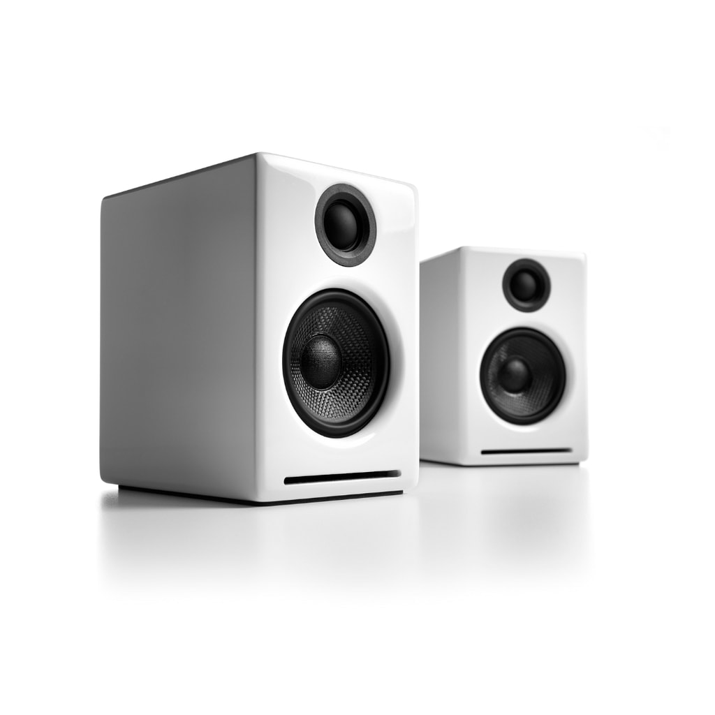

How small do you need? The AudioEngine A2+ is pretty small. It uses a 2.75" woofer to give you a sense for size.
I did not consider AE - I don't remember why I decided not to. But that’s a perfect size though, thank you, For a just slightly bigger size I’d get better resolution (not sure if relevant) with the HD3: 24-bit/48kHz vs 16-bit/48kHz.
