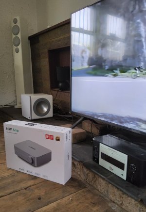

OK... so.
I pulled the trigger... if its not a jump in audio quality, it goes back !View attachment 6220
OK... so.

OP here ...
OK... the WIIM amp stays !
Superb piece of hifi ...
Quality streamer, Quality dac and Quality amp.
But
That amp needs to be carefully matched to sensitive speakers OR realistically assumed your setup will be within a small room.
However, using a sub, for which the WIIM Amp is absolutly engineered for larger volumes, punch and spl can easily be achieved in larger spaces.
It is a very very clinical sound through my monitor audio radius speakers.. which have metal dome tweeters to be fair.
But, when setting up my system the parametric eq is absolutely astounding at moulding the replay tuning to my ear. So, I have been able to bring vocals forward whilst also rounding off the dental like high transients altering the 'q' on the high shelf basically sounds like a Marrantz presentation now rather than the Linn'esque dry soundstage.
I'm crossing a fast bass Cambridge Audio minx sub in at 125 hz ... allowing the WIIM amp to use its magic free of the heavy lifting.
EArc has been great 👍...
