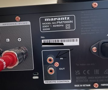

Ah. So a 3.5mm to RCA cable plugged into the trigger socket on the WIIM and the remote in on the Marantz won't do it?
No. The PM7000n does not have a remote control-in. So it will only work as per my previous post.

That in out only works from another Marantz unit.

I think it might work to connect 2.5mm (NOT 3.5mm) cable from the Pro Plus to the Marantz. I would ask Marantz support directly.
It will not work. Compatibility is only across Marantz devices as stated above. However, the solution proposed by audiobliss might work.

I get it. The Marantz jacks are for IR commands, not a 12V control line. If I correctly understand the functioning of Audiophonics trigger, it is basically a switched outlet. I don't think you can get the Marantz to turn on by simply applying AC Power to it.
I think what is needed here is a device that would take the 12V signal from the WiiM and convert it into and send the ON command via IR or the network to the Marantz.

Does you Marantz have a 12V trigger in and out?
