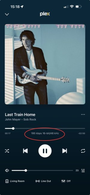

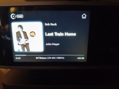

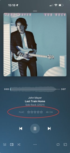

I'm not getting 24 bit on the Plex integration either... Original file is 24 bit but WiiM is playing 16. It plays the correct sample rate. It is happening on all files.

What device is that on? The Ultra firmware had a bug that’s only just fixed ( FLAC playing as mp3) but that’s not rolled out yet to other devices as far as I’m aware.
It is on the Ultra. Says the firmware is up to date.
There might be a metadata issue... but the 24-bit version is still working...
Wiim streamer latest firemware i have is 5.2.804553 build date 20260114

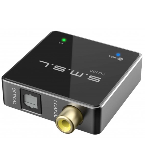

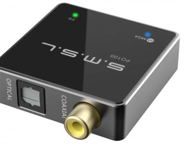

weeeeeee now it works from my pc SMSL PO100 2024 USB, i didn't even have to install any usb driver
