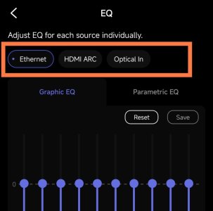

Am I blind or is there no Pre-amp function on the EQ device settings?

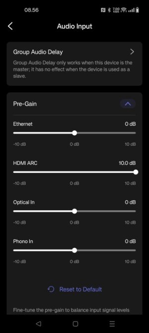

but you can use manuelly the pregain mode....as a way around the subject...
