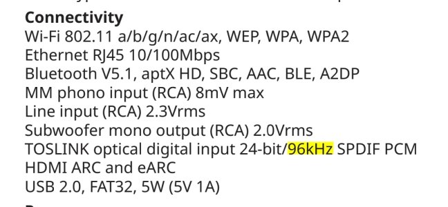

Yes, as @Wiimer says it would appear that it only supports up to 96 kHz, as the specifications quite clearly state.
