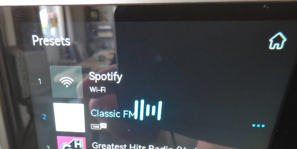

Hi
Classic FM is a good example as its not regional.
I find it in the App, add to favourites and preset, works perfectly, get the station logo on the screen.
The next day, select preset from the Ultra unit screen, select Classic FM. No logo, pressing play does nothing.
Hi

I just tried to select Presets from the Ultra screen and that didn't work at all. Nothing happened when pressing an entry until I edit one of the entries (in WHA), then all works again. That is a new bug.
Just tried again, I have preset one as Spotify, which is fine.
Classic FM as preset 2, pressing on the remote, nothing happens.
Works from the App
Doesn't work from the unit screen
