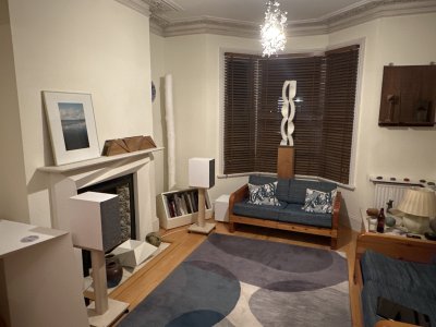

Thanks. I really appreciate your input. They are a pair of Dali Optocon 2 Mk2. Far from ideal placement. Firing across the room. About six feet apart and eight feet from the listening position. The room is a bit of a nightmares acoustically. Very minimally furnished and lots of hard surfaces. I do have some acoustic panels on order to try and ameliorate this.

Thanks for sharing the pics!
+1 to @harkpabst's comment.
In a room that size (quite small), I doubt added watts are going to be much help.
You might want to take a look at either floorstanding speakers (e.g., https://us.kef.com/products/q11-meta?variant=49014963994871) or adding a sub (e.g., https://www.svsound.com/products/sb-3000), but both with room correction, before upgrading your amp. I think the sub might be more appealing, as it has an integrated / additional amp that will lighten the load on your WiiM Amp and your bookshelf speakers, while the floorstanders would require your WiiM Amp to work harder. The cost will be a little extra effort of finding the best placement for your sub in a fairly constrained space.
This forum has plenty of good threads on those topics.
And... that all said... it sure looks like you already have a sub in the picture!

What I see from the photo are 2 speakers backfiring into their own recessed wall with a fireplace on either side. You’re going to get a ton of bass buildup behind those speakers causing the phantom image to be blurry. Hence the bad soundstage. Bass traps are your friend here.
