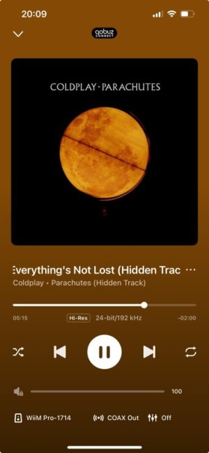

Hello,
I am using a WiiM Pro and using the coaxial digital output. To avoid a bunch of trial-and-error, I am looking for recommendations on RCA cables that you know from experience will work all the way up to 192kHz. I am currently using a Mogami 2964 RCA cable (brand: World's Best Cables) that I originally purchased for an analog audio interconnect, and it was fine up to 96 kHz, but silent at 192kHz.
Note: I did find an old set of component video cables lying around and I did have success using one of them for 192kHz files, so I know the rest of my setup is OK for playing 192. But this cable is way longer than I want to use, so I am in need of a new RCA cable that will work for 192kHz daudio.
Thank you,
Greg
