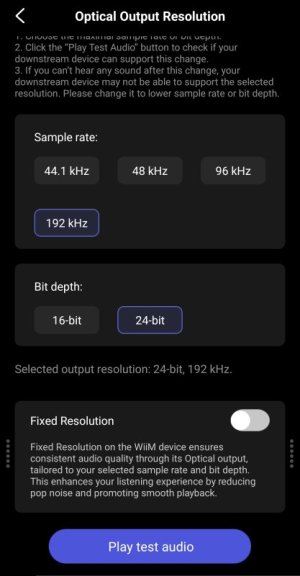

I realise you've already confirmed this, but the Coax output resolution screen in the WiiM app is set to the same configuration as this screenshot, correct?
