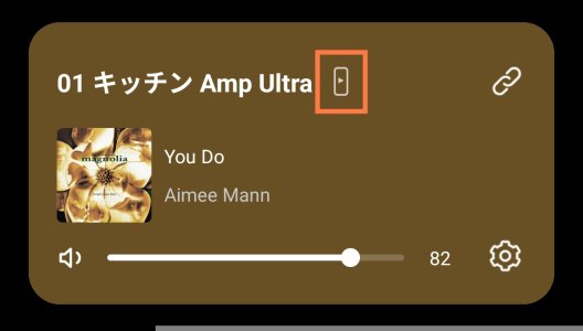

The WiiM Remote's power button is a toggle switch for standby mode. The power never fully shuts off; even in standby, the device and Remote remain connected via Bluetooth. (However, disconnecting the device's power cable will sever the connection with the Remote.)
After pressing the Remote's power button to put the device into standby mode, is the Remote icon displayed on the device card within the WiiM app? If this icon is missing, the connection to the Remote has been lost.
If the issue persists, please first attempt to reboot the device.
I can't tell. I'll check when at home. But I presume as the remote don't work then this link icon won't be there. I did reboot the wiim multiple times too.
