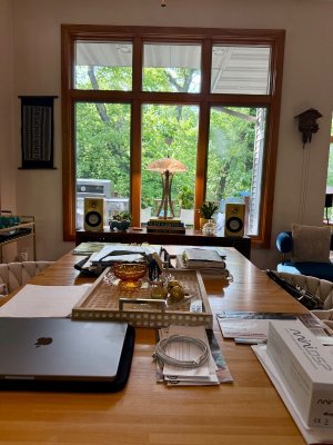

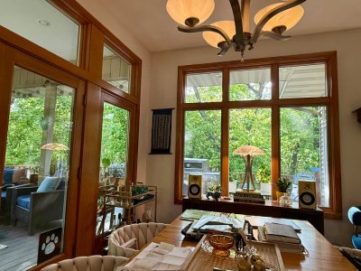

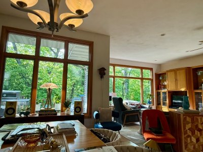

The bookshelves are just under six feet apart on top of a vintage stereo console and about 18 inches in front of large windows (see pics). The subs are hidden inside the stereo console directly beneath each bookshelf.
My listening position is about 10 feet away at the end of a wooden table typically covered in miscellaneous stuff. To my left is a large bank of floor to ceiling windows and to my right is open to my living room, and behind me is open to the kitchen area that is ten feet back. My floor is hardwood with a large rug under the table. Walls are plaster, and ceiling height is ten feet (see pics).

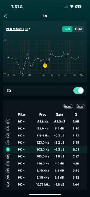

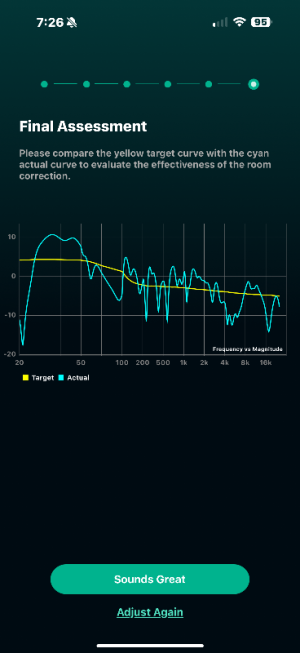

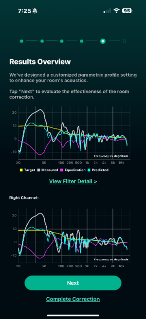

The initial room correction measurements for both Left and Right above 1kHz look pretty good (see pic). However after WiiM’s equalization is applied (see pics) the measured result shows large dips between 4-7kHz and just over 16kHz (see pics).
Those large dips don’t correlate at all with the Eq applied by RC so where did they come from???
This problem is occurring when doing either L/R individual correction or the stereo correction. In fact it gets much worse when doing the Stereo correction.
