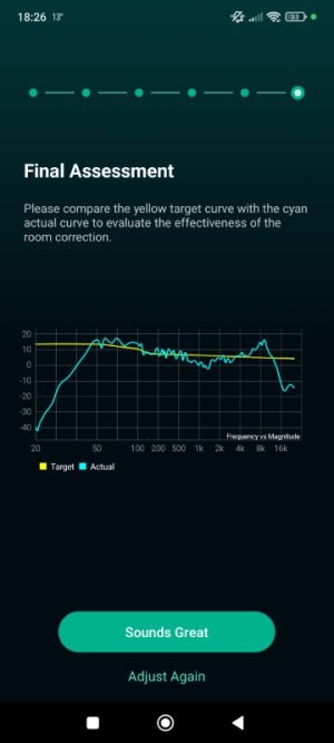

I forgot to take a screenshot of the previous screen. Is it possible to do the same from this one?
From these screens I can't say for sure whether or not the dip was resolved.
But more importantly, are you happy with how it sounds after correction?
No, because it reduced the bass.
I will probably use wiim without room correction.

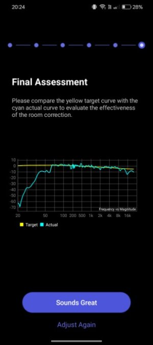

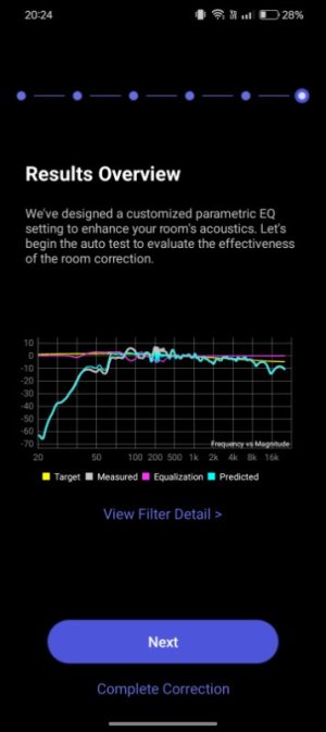

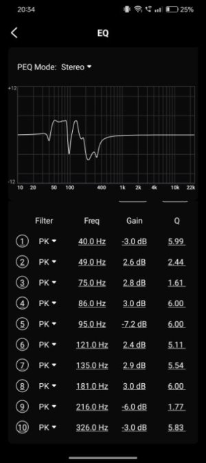

Hi all!
So today I tried Room Correction using the values suggested by @dominikz (thanks a lot!) with an Umik measurement mic.
I have a Wiim Ultra and Dynaudio Special 40 without a sub - I set the lower frequency range to 40hz because the Dynaudio Special 40 get down to 41hz (+/- 3db) - is this correct, or should I still set it to let's say 20hz, any recommendations?
Considering the curve, I guess it looks decent, any comments? Definitely sounds good to me, just wondering if there are any anomalies as I'm rather new to this 😁 Thank you

Hi all!
Did you import the calibration file for your UMIK-2, as planned?
The PEQ filters look pretty typical and OK for me but the 10 dB step around 55 Hz looms strange. What phone did you use? Unfortunately this sometimes makes a difference, even with a calibrated external mic
The slope of the curve appears to be roughly 48 dB per octave. This indicates the presence of another high pass filter. Either just in the measuring device or in the real chain.
Note the vertical resolution not 85 dB.
Thanks for you reply - yes, I used the standard (as in not the 90-degree) calibration file. I used an Oppo A77 Android phone in the process. My chain is Wiim Ultra --> Chord Qutest dac (with the "incisive neutral" filter) --> Audia Flight FL Three S integrated amp. Tomorrow I'll try the Individual Channel correction to see what it comes up with 🤔
