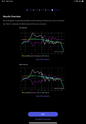

I have tried room correction in various ways with highly variable results. However the attached screen grab shows my latest attempt. It was achieved by taking three measurements for left and right, the first in the sweet spot, the second 30cm to the left and the third 30cm to the right. Frequency range 40-6000Hz. Any comments?
Are you using calibrated microphone?
Limit correction to 300hz
Are you using the "Precision Room Correction" switch in settings?

Which microphone did you use? Phone mics don't work well at low frequencies.
Which microphone did you use? Phone mics don't work well a low frequencies.
That may be it, then. I have only ever used my iphone 14 Pro mic. Have a friend who has a UMIK-1 which I could give a try. Maybe that should be my last resort before I throw in the RC-towel completely. Was not aware that that could make such a big difference.
Worth a try. Also try different target curves.
