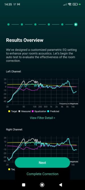

Now some bass below 70Hz is visible (and it wasn’t there before), so it doesn't look like you just raised the overall volume.
It looks as if you only now turned the subwoofer on, or perhaps increased subwoofer volume, or that you used a different mobile phone to measure.
To be able to estimate optimal RC parameters I'd need to understand how your low frequiency response looks like, so I can't help much when the measurements are this unreliable. :confused:

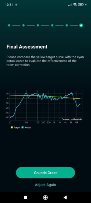

I'll try to give the results one more time and if it's still the same, I'll give up.
The fact is that this setting will reduce the bass.

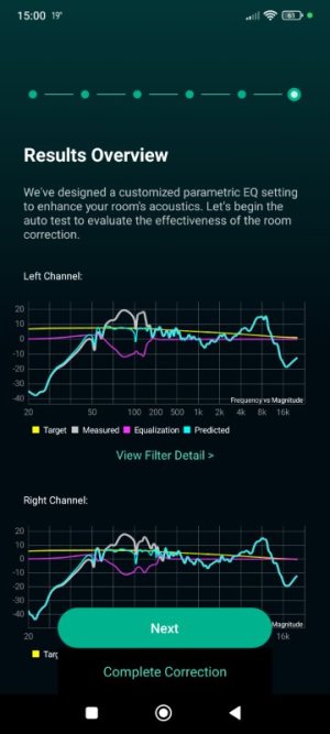

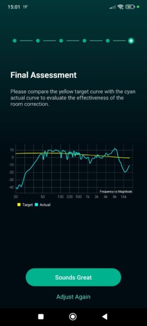

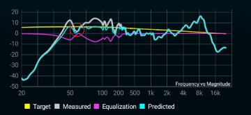

@Adam205 Your measurements look incorrect - once again there's almost no bass below 70Hz. Compare these last measurements with the ones you posted in post #166 (which had a much healthier bass level).
Please, can you point out the bass on that graph for me? What should I focus on so I can post the results here correctly?

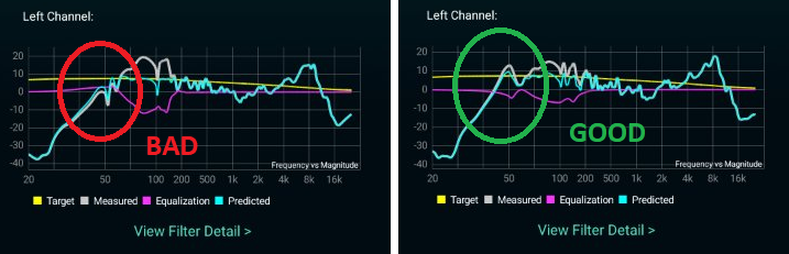

Sure, I hope this illustrates the difference well enough:
Measurement on the left is the one you posted today and you can see the white curve is significantly below the yellow target curve in the red circled part. This looks as if the subwoofer is disabled.
The measurement on the right is what you posted in post #166, and here you see the white line in the circled section is quite a bit higher than on the left. This looks better and gives a more usable level to the WiiM RC algorithm.
However in both cases I can't be sure if what your phone microphone is measuring is representative of the actual response in your room. This would require use of a calibrated measurement microphone.

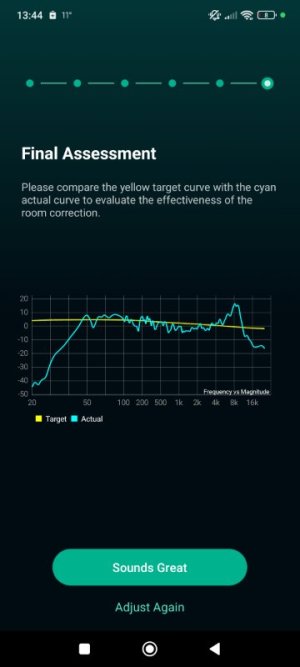

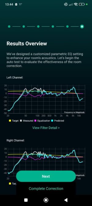

@Adam205 That looks reasonably OK to me.
As I said before, if you want you can try to increase subwoofer volume by about +5dB (use the volume knob on the back of your sub) and re-run RC with the same settings to see if you can get rid of that dip at ~60Hz.
The reason for suggesting to increase subwoofer volume is to get the circled part of the white curve ('dip' or 'null' in response) to get closer to the yellow target curve.
A better way to fix this dip in the response would be to try moving the subwoofer a little, but you said that is not an option for you. Would you perhaps consider rotating the subwoofer so that it faces to the right instead of facing towards you?

Unfortunately that didn't help much, RC algorithm made some unfortunate decisions when calculating the filters.
Perhaps try to change Max Gain to 6dB and re-run RC. If that doesn't help then I guess you'd either have to accept the response dip or try alternative subwoofer positions.
