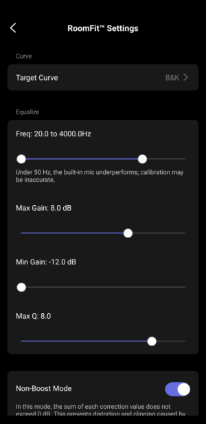

In my opinion, after using wiim ultra for a few weeks, if you want good sound, you should use room fit to measure the room's acoustics and use the graph results as a standard. Next, I set the db and Q, Gain of roomfit to default because I prioritize EQ first, I adjust the EQ until I hear the clear sound with all the bass, mid or treble frequencies that I like, then I adjust the EQ of room fit to compensate for the frequencies where the sound has not reached the purity, vividness and sparkle, and here are some of my wiim home settings to share with you to experience!
Thank you for sharing your settings. That is an interesting approach to prioritise EQ first then adjust RoomFit to compensate. I have been working the other way to use Roomfit and leave as is, then adjust either EQ or PEQ to my tastes. In the example above I used Housecurve to get the Roomfit curve closer to the target curve and the results sounded very impressive, a better job than RoomFit did. I am going to have another look at changing the PEQ settings manually to adjust as they seem to give more control than EQ. This is all fun:)
Just note that RoomFit automatically disables EQ when doing the measurement to create the profile initially. Once the profile is created, EQ is automatically reverted to previous state.
You can however see the cummulative effect of EQ+RoomFit with the new "Evaluate" function (when you access the saved RoomFit profile edit mode).
