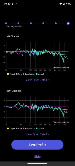

Ok, final try! It's still quite similar and I cannot seem to get rid of that weird dip aour 100Hz, but I really don't know how I could still improve. I guess the glass behind the speakers is not ideal, but if that causes the dip?
What did you change to get there?
The dip below 100 Hz looks more severe than ever to me.
A bit more gain on the sub and a bit more toe-in on the speakers. I really don't know how to get rid of that dip.

If it already sounds good to you, you can stop right here. The results are pretty good already. Note that the vertical resolution in your screenshots is just 40 dB, so the measurements are very granular and putting more visual emphasis on dips and peaks than many other results posted here.
Furthermore, research has shown that narrow-banded dips are hardly an issue for human perception, quite different from peaks. If you are specifically sensitive to this exact shape and depth of a dip, only you can tell.

@harkpabst Actually the same 100Hz dip existed in previous attempts as well, and also only in the evaluation response (cyan) - the same as here. See here and here to compare with this latest one here.
@Aziraphale IMHO this latest RoomFit looks better than all of the previous ones, mainly because the response below 50Hz is improved, and the dip at 55Hz is a bit shallower.
The 100Hz dip is some kind of interference between the two channels that is more difficult to troubleshoot. It is relatively narrow, and in any case should only apply to center-panned content, so it may not be as audibly problematic as it looks.
If you're happy with the sound then no need to continue investigating, IMHO.
If you want to continue, however, then I suspect you might need to experiment with placement some more.

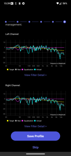

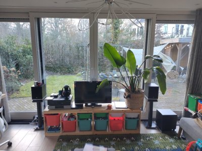

I keep on trying.... :geek: Only downside is my wife and son playing a game in the next room and not being perfectly quiet.... :ROFLMAO: The 100Hz dip looks less, but I'm not so sure about the rest. I've also added a photo of my setup from my listening position.
