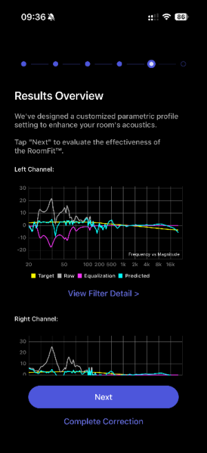

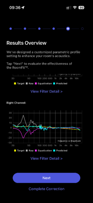

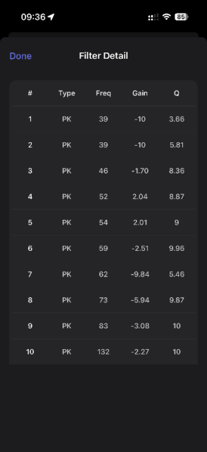

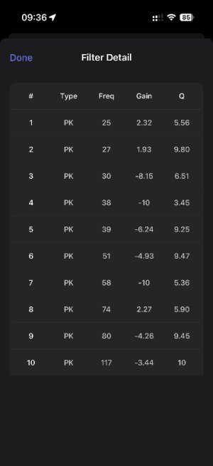

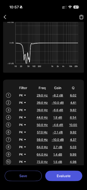

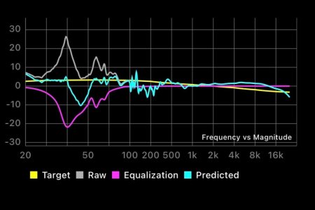

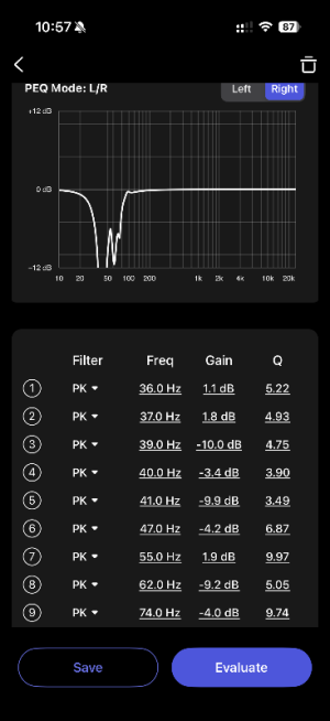

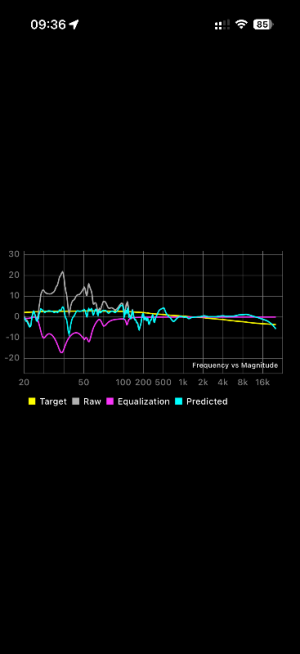

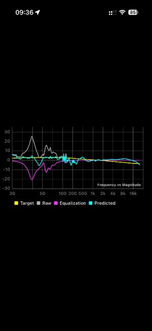

hi all,
I'm using a Wiim Ultra with Spotify lossless and also Roon direct out in coax to AsciLab C8C active speakers.
This is my first ever attempt at proper room calibration and I'd like your opinions please
I read for quite a while before "acting", asked questions, and because RoomFit has made quite a lot of progress I decided to go with it vs tinkering with REW which is more complicated and I don't intend to spend endless hours on this (thanks @dominikz for the help).
So I bought a UMIK-1, loaded the 90° cal file into RoomFit and the following settings
Range: 20 or 25 Hz to 300 Hz, Target: B&K, Non-Boost Mode: On, Channels: Individual channel RoomFit, Smoothing: Variable.
I used MMM measurements.
Volume on Wiim was at 57.
This is what I got. I'd like to get some feedback on what you see because honestly it's not telling me much.
I blindly applied the filters proposed and now I'm listening with and without RoomFit and feel that it really removed a lot of bass, a bit too much to my taste. Essentially I felt that before, there was too much bass, and now not enough if that makes sense.
Any support would be helpful
Many thanks!

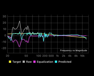

Many thanks!
