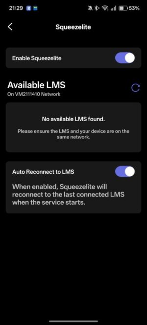

One of my Pro plus wiims can't find LMS. I've rebooted, factory reset and all the usual stuff. My other pro plus and ultra see it just fine. Obviously I'll raise a ticket.

1. Even now that my old NAS hosting DLNA is decommissioned, I still sometimes find my WiiM disappears from Lyrion as a player. This is fixed by rebooting the WiiM. I still haven't worked out exactly what causes it, as it seems inconsistent.
I had the same issue with my WiiM. In my case I isolated it to streaming certain FLAC radio stations (Radio Calico, I think was one) when one song changed to the next Squeezelite would crash, it would disappear from LMS and only a power cycle of the WiiM would bring it back.
Yup IIRC some FLAC streams with embedded metadata cause the WiiM version of Squeezelite to crash.
I am still having this problem and I don't think the FLAC thing is the cause.
Scenario: Play local FLAC music which always plays fine. Come back the next day and find the WiiM is not visible in LyrPlay until I reboot the Wiim.
I just had a thought. I have the amp set to display the clock when in standby. It looks nice but I often turn the amp "off" using the remote (top left button). It's not really powered off but the display is off. I do that to possibly save unnecessary wear on the display, not that it probably makes much difference. I might stop doing that to see if the amp stops disappearing from LMS.
Thanks, though that won't be the cause of my issue. The amp is 3-4 metres from the wifi router with one wall in between. LMS is on a box connected to the router via ethernet.
