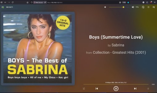

Zero issues with LMS, apart from if I switch off my NAS, then back on again I need to reboot picoreplayer,probably to do with mounting.
Not a big deal
picoreplayer
craig drummond lms app
