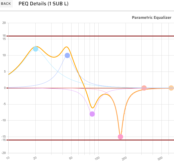

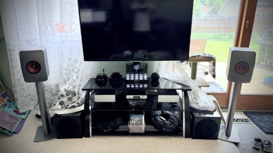

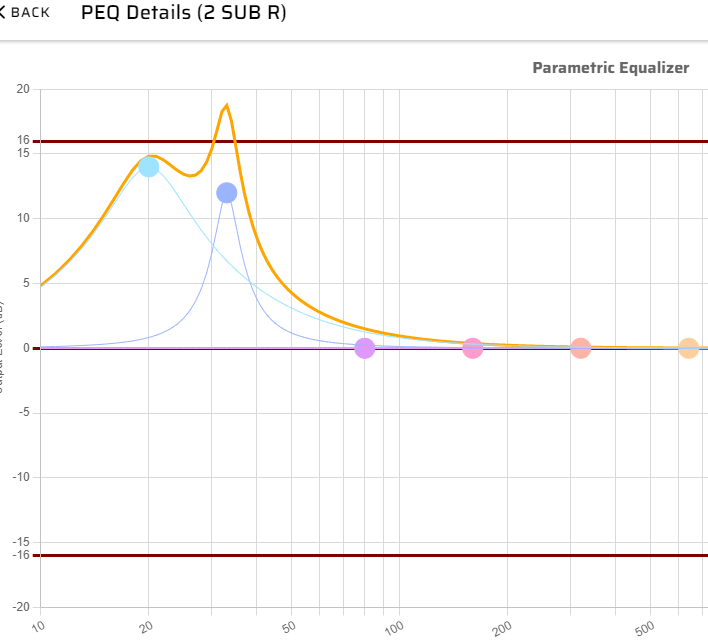

I already had a MiniDSP Flex Eight doing it’s thing before I got the Ultra so no change there. My two closed box subwoofers crossed over at 45 Hz both get mono signal but they have individual EQ/room correction. Gotta love miniDSP.
Above 45 Hz three way dipoles.

The room correction applied in my setup is for subjective linearity, and it’s been done manually. 10 PEQs/ch in the Flex Eight.
1677832557856-png.898135
1677832655185-png.898136
Room assymetry leads to some nodes that need more taming on the left side than the 4th order LR crossover at 45 Hz can provide.
