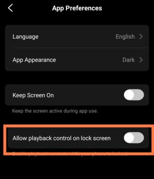

If I just launch Tidal from my iPhone 17 Pro on iOS 26.3.1 and send the music to my Wiim Sound using Tidal Connect I can not control the volume, nothing happens when pressing the physical volume buttons on the phone (other than that I can see the slider change).
But, if I then launch the Wiim Home app (with Tidal still running) it then starts to work if I switch to the Tidal app again... Even if I close the Wiim Home app it continues to work from within the Tidal app, until next time I use/relaunch it.
"Volume normalization" is disabled in both apps.
Any ideas on how to fix this?
