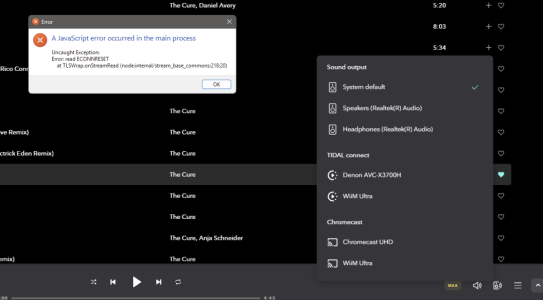

None of the following work:
1. Full network reset, modem and router disconnected from power at wall socket and then rebooted.
2. Removing WiiM Ultra from power and reconnecting it to power by removing plug from wall socket.
3. Reset to factory default settings (WiiM Ultra).
4. Full power down and restart of Android Samsung S22+.
5. Complete deletion of Android WiiM Ultra app, power down of 'phone and restart, followed by re-installation of WiiM Ultra app after powering up 'phone.
5. Clearing cache and forced stop of WiiM Ultra app in Android.
Tidal works fine using the dedicated Android Tidal app when casting to my Denon AVC3700H receiver (Tidal Direct & Chromecast)
Tidal works fine using the LG C1 OLED TV app on my television in conjunction with my Denon AVC3700H via HDMI.
Tidal works fine using the Windows 11 desktop app, I can cast it to my Denon AVC37010H using Chromecast and Tidal Direct.
Tidal refuses to work at all using WiiM Ultra. Logging in to Tidal is impossible.
I have no other ideas as of how to resolve this now. I have submitted a support ticket.
In the Windows 11 desktop app I'm getting the following Javascript error when trying to cast any tracks to the WiiM Ultra when trying to use Tidal Connect or Chromecast. Casting Tidal using Tidal Connect to Denon AVC-3700H works fine, as does casting to Chromecast UHD under Chromecast. WiiM Ultra casting works with neither.
