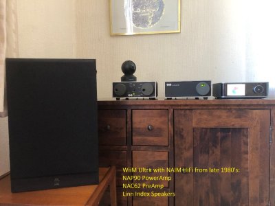

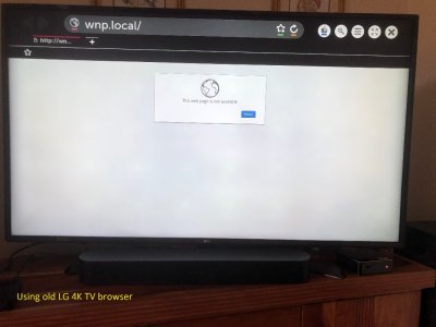

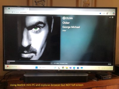

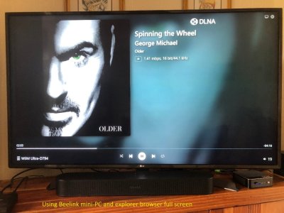

Hi, I recently bought a WiiM Ultra to use with my late 1980's NAIM HiFi gear to bring it up to date. I saw the discussion regarding the "Now Playing" feature shown on John Darko's YouTube channel. I was very interest in this very nice solution using the wonderful Raspberry Pi computer boards. I wanted to have a go at getting this to work with my HiFi setup. I decided to use one of the small Raspberry Pi Zero 2W boards so I bought one together with a nice little case and power supply. It was pretty easy to follow the Github software installation instructions and within an hour or two it was up and running. I wanted to use my old LG 55inch TV to display the "now playing" information. The LG TV internet browser would not work on it's own and only displayed the helpful message "This webpage is not available". I resorted to using a small Beelink mini-PC connected to the LG TV. That worked very nicely. However it would only display the full album artwork when the browser was set to "full screen", otherwise the artwork was cropped. It works perfectly using the mini-PC browser full screen. For those that may be interested my old 1980's HiFi gear is a NAIM NAC62 PreAmp, NAIM NAP90 PowerAmp and Linn Index speakers, all are still working perfectly after all these years! I've attached some photos below showing my setup and results. Overall I'm very satisfied with this little RPi project, so many thanks to the kind software developers who created it. (y)👏
