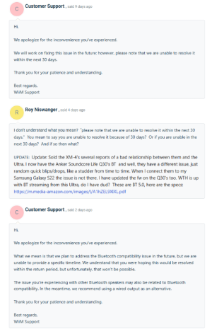

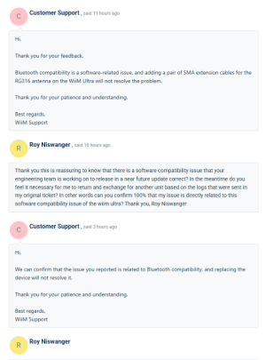

I am still having issues here, not sure what the problem is but it is isolated to the WiiM transmission since streaming from my phone, wife's phone (different mfg), son's phone (same mfg but different model) and my original DAC the FiiO BTA30 Pro does not create the issue. I'm opening a ticket now. Thank you.
