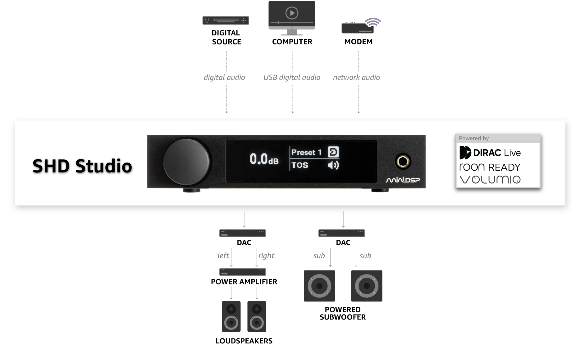

Output Flow of minidsp SHD studio
In the example, as you can see, digital crossover can be implemented in the DSP of the streamer, and 2 seperate paths for main and sub.
Users can pair their prefered DACs(for main and sub respectively) for higher audio quality.
Yes? So this would help you right?
I have owned one (miniDSP SHD Studio), for the scenarios you mentioned it is unbeatable.
It also has a built in Streamer that is Roon Ready, or you could connect your own digitally.

BTW, to me your use case sounds more fitting for a miniDSP SHD Studio.
It has several digital/analog inputs and outputs and you can choose what to send where via their configuration tool.
my idea actually comes from SHD Studio, you suggested.
