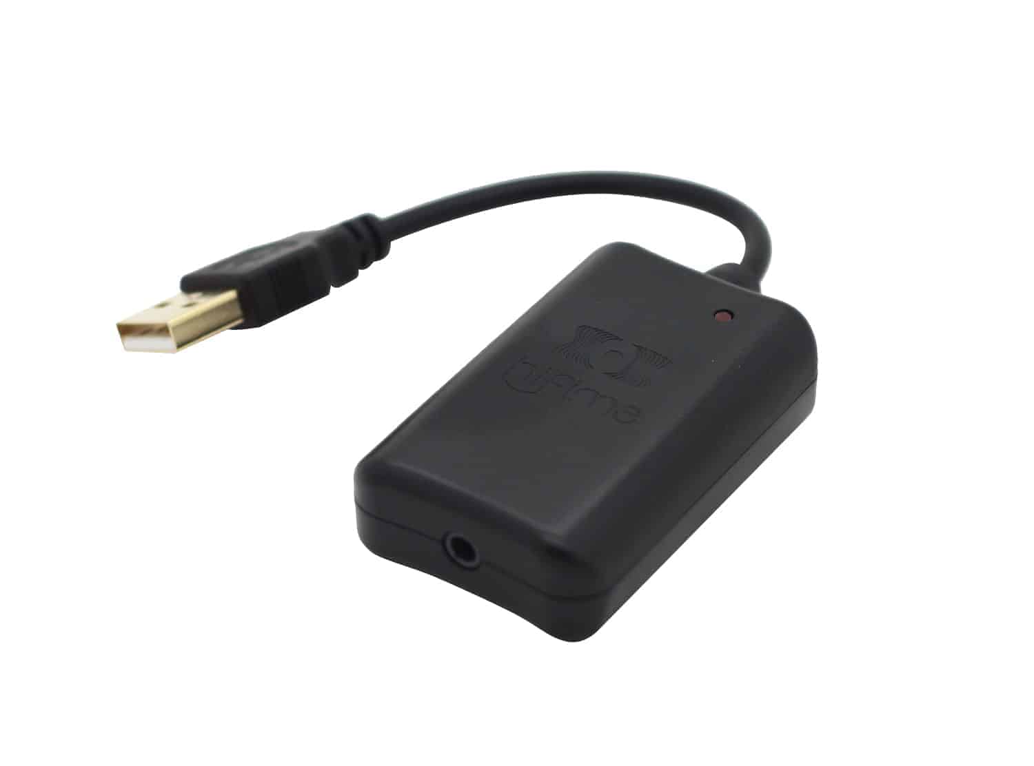

The Hifime UR23 SPDIF Optical to USB converter has a hardwired USB A connector and a mini Toslink socket for an optical cable.
It draws its power via the USB connector.
I have never encountered an audio device that will supply power to a device connected to one of the audio device's USB input ports
You just plug this directly into USB on a PC or a Raspberry Pi and it will get power from the host device. A powered hub is only necessary if there are too many other things being powered from the same host.
It’s actually a USB to Optical/3.5mm Aux converter. It incorporates a reasonable quality Sabre DAC capable of 24/96 IIRC. I have a couple somewhere or other.
I don't think you have this one as you are describing a SPDIF output device. This is for PC recording from SPDIF to USB.
It can't be connected to a DAC according to the manufacturer so has no use as proposed here, that is to connect a Wiim to a USB DAC.
"Please note that it can’t be connected directly to a USB device like a DAC, it must be connected to a USB host like a computer"
It can't be connected to a DAC according to the manufacturer so has limited use here.
Apologies you are correct.
That is dangerous as it looks identical to something do have which is a Sabre DAC
