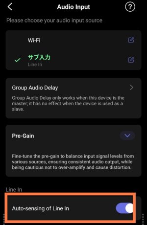

Hi, welcome.
There are primarily two methods.
1) Enable "Auto-sensing of Line In" in the Audio Input section of the device settings. This will automatically switch the input to Line-in when you play a record.
However, this method may cause the opening sounds of the record to be cut off. If this does not work, please try the presets.

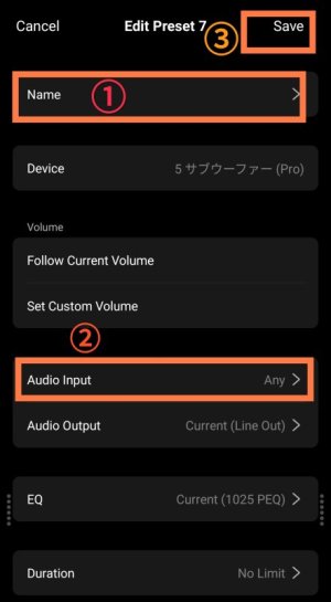

2) Open the Presets screen in your device settings and tap the three-dot icon to the right of an empty preset.
Settings on the preset edit screen:
1) Enter a preset name.
2) Change the input to Line-in.
3) Tap the Save button.
Now, pressing this preset button will switch the input to Line-in.
Presets can be accessed via the Pro device button or the 'Favourites' section in the WiiM app. If you have a remote, you can also use the preset button on the remote.

Hi, welcome.
