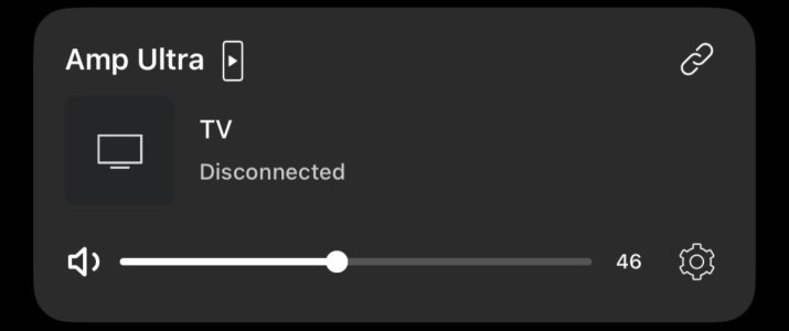

The only slight negatives for this device is that in the device card, it shows as Disconnected.

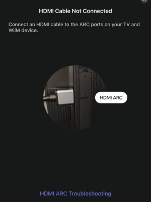

The now playing view screen shows "HDMI Cable Not Connected".
The following screen appears when you select the Blue Question Mark seen in the above screenshot.
Other than the above minor issues, this adapter works very well for me, and has freed up the Optical Input on my WiiM devices, so that it can be used for other things.
The missing connection is because the WiiM cannot detect the HDMI CEC signal.
This is not mandatory for using ARC, only for volume control via TV.
WiiM do however expect this and use it for auto sensing of HDMI in addition to the volume control.
