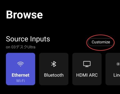

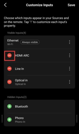

In setting up the Ultra I had to use utilize HDMI ARC. And though it's provided the benefit of only having to use one remote control for three different devices, it also automatically choses HDMI ARC as my primary input regardless of my choice (phono, optical ).It may be in the instructions on how to properly utilize the Hide function, but it took me a few days to stumble upon it. By Hiding HDMI ARC, the Ultra now stays on the last-selected input, which is how I use it 98% of the time.
