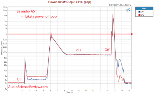

the Vibelink replaced 3e audio A5 for me, which doesn't have any pop when turned off/on
ASR measurements have shown that pop noise is generated when the 3e audio A5 is switched on and off.
couldn't hear any pop from the speakers when the A5 went into standby - only its relay clicking sound from within the amp.
