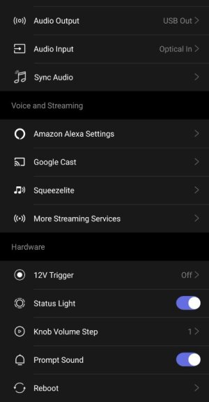

The wheel doesn't work at all, for volume or just to control the home screen. I have to do everything via the remote. I had to do a system reset on the Wiim app as I cannot use the wheel and still not working. The status light doesn't turn on either, even though it's toggled on on the app. I believe it's an hardware issue. This will be my second Wiim Ultra after the first had issues with the USB and line in ports not working. I have logged a ticket with Wiim Saturday, but I have not had a response
The center of the volume knob should not only function as a status light, it's also a push button toggling between play and pause. If you push it, does a play or pause icon show up.on the touchscreen?
If not, it really could be a hardware issue where the entire subassembly does not get electrical power.
