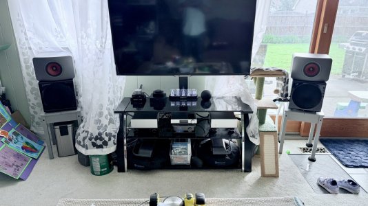

Yes I currently am forced to use room grouping of my WiiM Ultra with a WiiM Pro Plus in order to utilize my system in 2.2 configuration because the subwoofer out on the WiiM Ultra is only monaural. I really wish the WiiM Ultra supported stereo subs so I don’t need the extra complexity. That being said, it sounds absolutely amazing with the subs crossed at 160Hz and everything perfectly phase-matched (my subs have phase control in fine 1° increments with a separate polarity inversion).

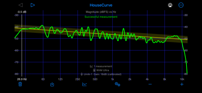

I am able to achieve incredibly smooth response:
However, if WiiM allowed stereo subwoofer output, I could significantly simply my system by removing the second streamer and no longer needing to rely on the grouping function which really complicates things.

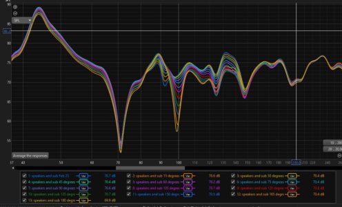

Ideally you want to get the two subs aligned with each other, once that's done then align the matched pair to the speakers.

With phase, adjust phase on one sub so you get a flatter overall response.
This is what adjusting phase on a single sub does to response to one speaker, but a similar principle stands for subs, you'll get difference response depending on phase on sub (plus of course placement of either sub)
Use REW room simulator to give an idea what dual subs do

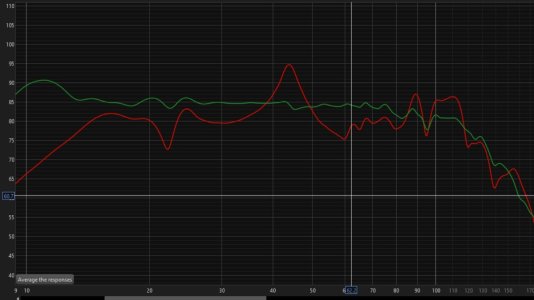

Without alignment, and EQ this is (second image) is before and after, that's with minidsp HD.
Try running a few REW sweeps, speakers disconnected.
Switch both subs on, phase on zero on both
Adjust second 45 degrees phase, run a sweep. Then 90, run a sweep, etc until 180.
Look at response and see what looks the flattest. Once you've got flattest response
Then run Wiim setup, that will then do time alignment of the two subs, then do EQ.
