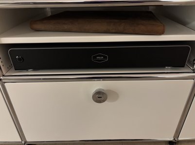

Well, have a look at the web site of Apollon. I‘m afraid they do have a led illuminated power button on the front. The Lux model don‘t, I think.
Buckeyes are also very plain by design.
At least the brightness level can be adjusted, down to 0 % if required.

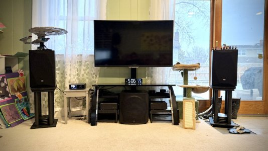

I think a lot depends on if starting from scratch or trying to include existing kit. In my case I already had a pair of stand-mounted active speakers and an active sub-woofer. So adding the Ultra has been a great and pretty inexpensive option for me.
