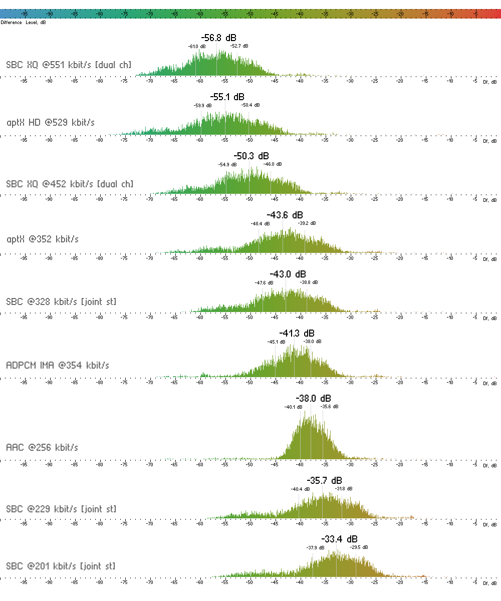

Yes. Pretty much everything that supports SBC supports SBC-XQ . The SBC protocol doesn't actually set a limit on how high the bitrate can go (in theory, it can go up to 730 kbps, which is transparent even to those with ears made of solid gold). The recommended bitrate is 320kbps (in practice often lower), but most devices have strong enough Bluetooth chips to transmit and receive higher bitrates. SBC-XQ is simply a way to force a higher bitrate on the SBC protocol, it's not really a separate protocol.
The Wiim Amp supports SBC-XQ, and for that matter so do Wiim's other products, like the Wiim Pro. Here's a screenshot of the Pro with SBC-XQ. I could also make one of the Amp, but the only difference would be that it would say 'Amp' instead of 'Pro'.
There's an article about SBC-XQ over here:
The server seems to be down at the moment, so if it doesn't work, here's a backup link:
