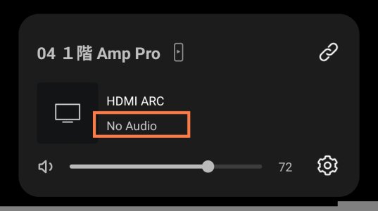

Additionally, should sound cease to be heard, please check the device screen within the WiiM app. (The current status is displayed on the device card.)

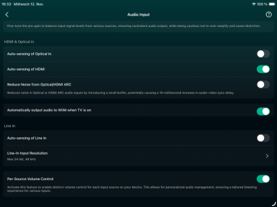

Make sure that ‚Automatically output to WiiM when TV is on‘ is toggled on.
This is unrelated to the sound. It's about how the CEC discovery is handled.
TBH I wouldn‘t know the difference with regard to it‘s effect.
Actually I would‘ve thought that CEC detection might exactly be the problem here.
If volume change still works, then CEC is ok.

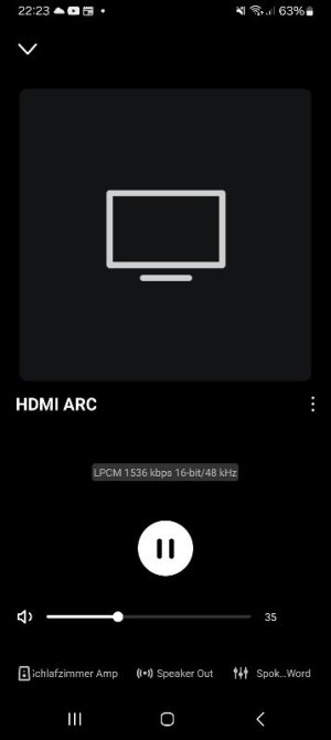

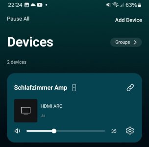

Thank you all for your input. I took some screenshot while there was no sound over HDMI ARC.
The currently playing page shows the pause button which indicates its current state is playing. Pressing the button has no effect to the sound. On the Devices page there is this icon with animated bars indicating something is playing.

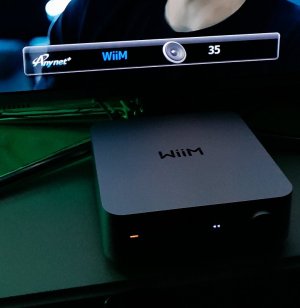

The TV screen shows the volume is controlled on the WiiM. When I change the volume over the Fire TV's remote control then the white LEDs on the WiiM indicate the volume change as well. Yet there is no sound unless I switch between different inputs (in my case switching to Line In and then back to HDMI ARC).

Did you ever get a resolution? I have the exact same issue except that it can occur after much shorter pauses.
I noticed I didn't encounter this issue over the past 2-3 weeks. So Issume it has been fixed even though I don't know how. That's the downside of over-the-air updates: things can suddenly break and get fixed again beyond your control. I can't even say what device caused the issue in the first place. It was either the WiiM Amp or the FireTV stick.
Are all your devices up to date? Unfortunately there is no further advice I can give.
Everything is up to date. At least now I can simply switch input from hdmi to line-in and back to hdmi to temporarily fix. Much easier/faster than rebooting the WiiM. I’ll try to capture the next occurrence and forward a ticket. 🤞
