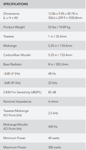

I received the new Wiim Amp yesterday and couldn't wait to set it up with my Definitive D15 speakers. However, I've encountered an issue—there's no sound at all.
I carefully followed the setup instructions, and I'm confident everything is connected correctly. Interestingly, when I tested the Wiim Amp with my Klipsch speakers, it worked perfectly. Additionally, my D15 speakers function flawlessly with my old Yamaha amp. This leads me to believe that both the Wiim Amp and D15 speakers are functional, but there's a compatibility issue between the Wiim Amp and the D15.
I've checked the specifications, and according to them, the Wiim Amp should be compatible with the D15 speakers. I'm puzzled as to why it's not working as expected. Unfortunately I will have to return my Wiim Amp if I can't figure out why.
