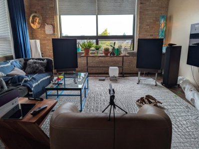

Here's my test set-up, the amp and sub will be relocated and wires hidden once I have decided on final locations for the amp and sub.
