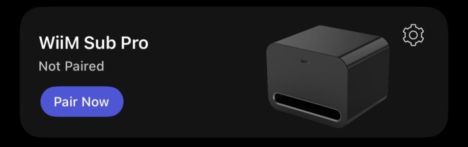

You could be onto something there, I have just unpaired my Sub Pro, and I now have access to the other three options in the Ultra Sub Out settings, and also have the following WiiM Sub Pro device "Tile". :unsure:
The Settings options available here are the same as in my post #19, but without "Move Sub", and "Unpair Sub from Ultra"

Yeah, I get that tile as I have my sub connected to my Linn Amp and wouldn’t expect to see anything under my Ultra settings where I have switched the sub setting off. TBH, I’d like the “pair now” highlight off too as it’s not sensible if the sub pro is attached to non-WiiM gear.

I have now paired it again to my Ultra, which tidies the device tiles up.
Perhaps the missing options will be enabled in the paired device settings in a future WiiM Sub Pro, or WiiM Home app update. :unsure:
