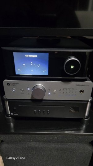

So, you are using an external DAC, feed the analogue output into the WiiM Amp Ultra's line input where an ADC converts it to digital again. The signal than goes through the internal DAC of the WiiM Amp Ultra and you listen to passive speakers connected to the WiiM Amp Ultra?
In that case all you.hear is additional noise and distortion from an additional DAC and ADC in the chain.
If you prefer the resulting sound, that's fine. But it's reall just a very inconvenient, unspecific and expensive way to alter the original signal. Chances are, you could have the same effect by simply using EQ. :)
Or perhaps...
Maybe the wiim line in has been renamed to CD Transport because they're using cd digital output to dacmagic to wiim.
Maybe the wiim optical port is already being used, so can't go digital direct to wiim?
Maybe the cd has analog out too.
Maybe that analog output directly into the wiim line in sounds worse 'cos the dac in the cd player is not great.
Maybe the dacmagic adds a certain je ne sais quoi to the sound.
But would it would imply is that the adc / dac of the wiim is at least preserving the characteristics of what comes in.
Admittedly, I still don't know.
This would be the only scenario where these two statements would both make sense: The CD deck has "a coax output" only and the DACMAGIC connected to line in "is an upgrade".
A coax to toslink converter might have done the trick for less money.
Ok' cd digital coax out to coax dacmagic input' then dac out to amp line in' works a treat & sounds great even if it over complicates things
