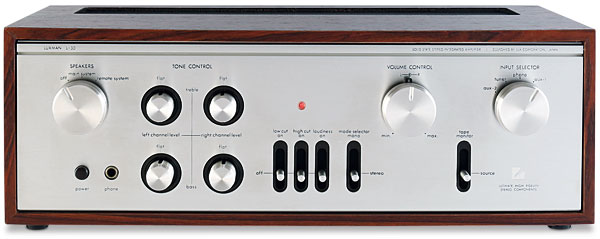

Hi all,
I am not very knowledgeable in audio stuff, trying to learn. I have a system setup that was inherited from my dad that consists of two JBL LX44 speakers (https://www.hifiengine.com/manual_library/jbl/lx44.shtml) and a Luxman L30 amp. However I need to give back the Luxman, so I am looking for a new amp and reading around I found the Wiim Amp which sounds really nice with all the streaming capabilities.
However I am not sure if it's going to be enough for such big speakers as I see it recommended a lot for shelf speaker type. So is the Wiim Amp going to be powerful enough for these speakers? Are they gonna sound good or should I look for alternatives?
Thank you!
I don’t know these speakers but the specs say they have a pretty high sensitivity (91dB) and the recommended Amp should have 10-150W. Since the WiiM Amp provides 60W@8Ω it should be fine. How big is the room and intended usage?
@handbag.mantels0i Remember this JBLs from the late 80s. Is it your model? Such 8 Ohms big boys needed really power to bring the best, even when the specs said different. Some marketing bla bla was ever. Your (beautiful) Lux is rated less than the WiiM, but....I am not the only one looking a bit skeptical to this fun-fi class D figures 😉
If I were you I would think about some "traditional" A/B amp and adding a Pro, Pro Plus or in not so far future the Ultra what will bring the streaming capabilities you want.
(My new standard recommendation for a smaller budget is the Yamaha A-S 301. Great connectivity very, very affordable.)

Whatever speakers this cute little low power entry level Luxman L30 can drive, the WiiM Amp can drive them better. Easily.
The JBL LX44 are not really big speakers and even if they were, that really says nothing about what size the amplifier needs to be. By today's standards one would probably call them "large standmounts", but back in the day nobody would put those puppies on stands. They went straight into a wall of cupboards (or even on top) or were placed plain on the floor. :)
With the Luxman/JBL combo, you may have become accustomed to a rather warm and relaxed sound with rather smoothed-off highs (especially if you've been using the tone controls and loudness switch). Should you feel that the sound isn't "full enough" with the LX44 connected to the WiiM Amp, simply add one of the existing EQ filters or come up with your own settings. Nothing wrong with that.

I am absolute with you about the L-30. But I wrote "beautiful" not "better performing" and i still think it is possible to let this combi swing.
And I beg pardon from everyone that I love the look more than the look of the WiiM. But thats as everything I write here my very personal sight which no one has to share 😉
I'm sure that @handbag.mantels0i would happily stick with the Luxman if he didn't have to give it back. :)
Certainly nice to look at and to use (except for the superfluous per-channel bass and treble controls).
