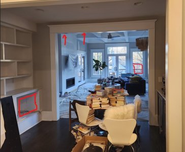

I have included an image below of the spaces if helpful to this conversation. Painting the place so it's the perfect time to rethink my previous setup. Cat5 and speaker wires (for both the ceiling speakers and the deck speaker) are in the right square in the bookshelf. The ceiling speakers for that wiring are shown by the red arrows and are decent but not the best sound no matter the input. The deck speaker is shown by the square in the right and just outside that window.
So I could have a WiiM Pro and a simple 2 zone amp in the bookcase to power and select the ceiling speakers and or the back deck speaker. I could also put the turntable here. The downside is that I think I'd need to rely on the ceiling speakers instead of the better Era 4 bookshelf speakers I have since the location is not ideal for sound if I had the Eras on the bookshelf since it's sort of trapped in that nook between the kitchen and living room. Maybe I'm wrong and it would be fine and I'm overcomplicating things.
My other option could be to get a small stand and put it in the living room for the turntable and WiiM Amp along with the Era 4 speakers. I don't have Cat5 there but guess WiFi is fine to the Amp. This would mean I would need another WiiM device for the bookshelf so I could have an input to the back deck speaker. I do have an old cheap amp I could use to power the back speaker.
I guess another option is to have an analog setup with the turntable and and use the Era 4 speakers on a stand in the living room. Then I would have one WiiM Pro connected to a 2 zone amp in the bookshelf so we could play music from our phones to the living room ceiling speakers and or the back deck.
