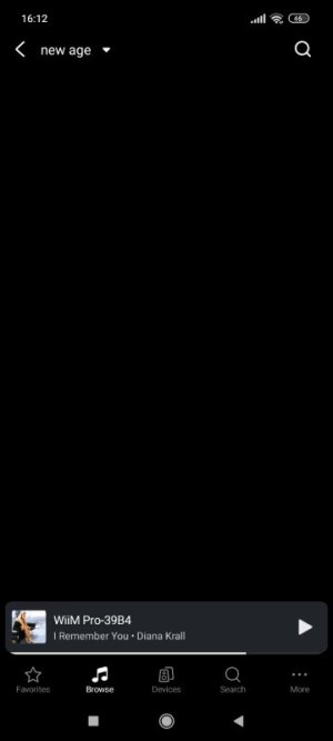

since december, in WIIM app I don't see songs within folder.
I use Mezzmo server on my PC and until december everythnig was flawless

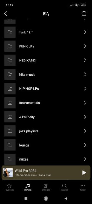

after I tun on PC. Mezzmo starts and on Wiim app I can acces HDD with music on it. music is sorted in genre and artist folders alphabelitaly.
but now when I choose folder to play song, inside is empty, no songs.
I tried older version of Mezzmo, no luck
I reinstall Wiim app and that day is OK, next day same thing.
other function on Wimm app works, just can't see songs. mezzmo server on PC work flawlesly.
what shoul I do?
here are 2 ss from Wiim app showing folders on my HDD and empty folder without songs inside
