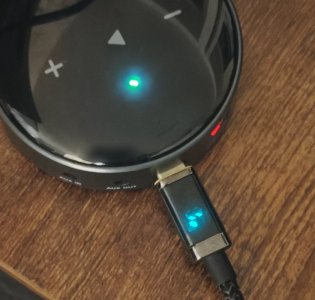

Hi everyone,
I’m having trouble with my WIIM Mini. It seems to be completely stuck: the device only shows a solid green light and doesn’t respond to any button presses (short or long).
I’ve already tried the following:
  • Unplugging the power for a longer period – it goes through a restart cycle but always returns to a solid green light.
  • It doesn’t show up in the WIIM app and is not connected to my Wi-Fi network.
  • Based on another post I also tried a different power supply, but that didn’t solve the issue either.
At this point it feels unresponsive and I’m not sure what else I can do.
Does anyone have suggestions on how to recover it, or is this a case for warranty/replacement?
Thanks!
Solution
So I bought a new charger, 3A 15W and now it is back working again. For now I'd like to flag it as 'solved'. Thanks for all the help!!
